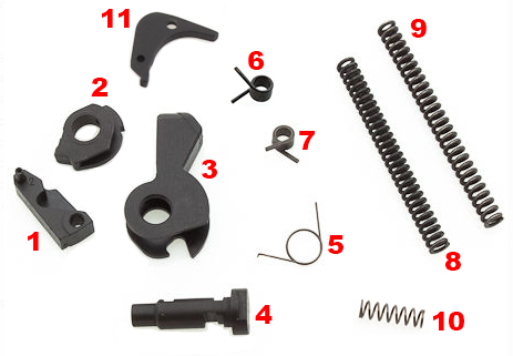

Required LEM Parts
1. Sear (50219439 or 219439)
2. Cocking Piece (50219443 or 219443)
3. Bobbed Hammer (50219452 or 219452)
4. Hammer Axle (50214258 or 214258)
5. Cocking Piece Spring (50219444 or 219444)
11. Catch (50219442 or 219442) <-- only for early 2005 (AF) or earlier date code
Light LEM Variant:
• Keep your V1 (DA/SA) TRS
• Keep your V1 (DA/SA) HS
• Keep your V1 (DA/SA) FPBS
Heavy LEM Variant:
7. Heavy TRS (50219441 or 219441)
8. Heavy HS - HK45C/HK45CT only - shorter spring (234460)
9. Heavy HS - USP/USPc/HK45/HK45T - longer spring (50214695 or 214695)
10. Heavy FPBS - (209962) <-- For USP/USPc only

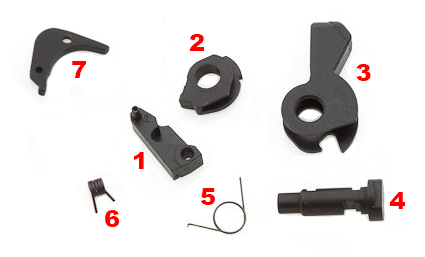

Required LEM Parts
1. Release Catch - aka Sear (209320)
2. Cocking Piece (209265)
3. Bobbed Hammer (209321) <-- not applicable if you are converting to V4.1 LEM
4. Cocking Piece Spring (209275)
9. Sear Actuator Latch aka Control Lever (209274)
V0 LEM Variant:
This is LEM variant with spurred hammer and decocker. Available only outside of the U.S.
LEM Spurred Hammer (209262, pictured below)
• You will not need parts 1 and 3 (LEM Sear/LEM Hammer)
• Keep your V3 Sear (with decocker)
• Keep your V3 HS and TRS (part #6)
For P2000SK - Keep your V3 HS (207122)
5. Light FPBS (50209296 or 209296)
Light LEM (V1 LEM) Variant:
5. Light FPBS (209296)
• Keep your V3 HS and TRS (Part #6)
Heavy LEM (V2 LEM) Variant:
7. Heavy Elbow Spring for Trigger - aka Heavy TRS (50219441 or 219441)
8. Heavy HS (50214695 or 214695) <-- for P2000 only
• Keep your V3 FPBS (206962)

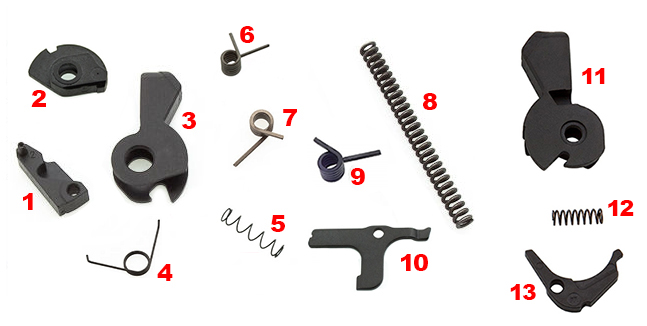

V4.1CH LEM Variant:
6. Light TRS (209266)
10. V4.1 LEM Hammer (207934)
11. V4.1 TBDS (207932)
12. V4.1 Catch (207933)
• You will not need the standard LEM Hammer (part #3)
• Keep your V3 FPBS (209962)

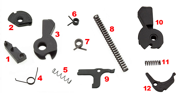

For P30/P30S/P30L/P30LS/P30SK/P30SKS
Required LEM parts
8. Heavy LEM HS (50214695 or 214695) <-- not applicable on a P30SK/P30SKS
10. Sear Actuator Latch aka Control Lever (209274) <-- not applicable on an S model (e.g.: P30S, P30LS, or P30SKS)
V0 LEM Variant:
• Keep your V3 TRS (234389)
For P30SK/P30SKS - Keep your V3 HS (207122)
6. Keep your V3 TRS (234389)
7. Heavy Elbow Spring for Trigger - aka Heavy TRS (234405)
V4.1CH LEM Variant:
9. Medium TRS (234773) or keep your V3 TRS. The stock V3 TRS gives you a lighter trigger pull.
11. V4.1 LEM Hammer (207934)
12. V4.1 TBDS (207932)
13. V4.1 Catch (207933)
If you want to lighten the final trigger pull weight by an additional 1/2 to 1 lb, you will need the Light FPBS (part #5 - 50209296 or 209296).

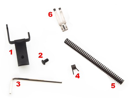

Match + LEM Hybrid
Required Parts
1. Match Trigger (215684)
2. Overtravel Stop Screw (215680)
3. Hex Wrench (958179)
4. Light TRS (209266) <-- Factory Match LEM Hybrid trigger uses the Light TRS for a more positive reset
5. Match Hammer Spring (215694)
6. Match Nickel-Plated Flat Sear Spring (215691)
7. Catch (50219442 or 219442) <-- only for early 2005 (AF) or earlier date code
8. LEM Sear (50219439 or 219439)
9. LEM Bobbed Hammer (50219452 or 219452)
10. LEM Cocking Piece (50219443 or 219443)
11. LEM Cocking Piece Spring (50219444 or 219444)
12. LEM Hammer Axle (50214258 or 214258)
Notes
• If you have an HK45, you already have part #7, and may not need parts #5 and #6. Double check to make sure your gun comes with parts #5 and #6 from factory; some do, some do not. Many recent models (BC date code and later) no longer come with parts #5 and #6 from factory. If your hammer spring is painted Blue, it is not the Match hammer spring.
• If you have an HK45 Compact, you already have part #7, and may not need part #6. Double check to make sure your HK45c comes with part #6 from factory; some do, some don't. Many recent models (BC date code and later) no longer come with part #6 from factory. Part #5 must be cut to size to fit.
• If you have an HK45, HK45 Compact, or USP Compact, you will not be able to use the Match Trigger assembly (part #1). The stock trigger can be drilled and tapped for the overtravel stop screw, or the Match trigger must be modified to fit the smaller trigger guard. The USP Compact models have very little overtravel room in the trigger guard area so a stop screw may not be needed at all.
