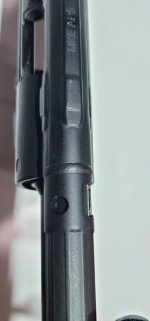

The SB tactical side folding brace and adapter. Well, it's okay. It's a brace, we all knew going in those are a poor substitute. It locks securely enough, it fit fine on the pistol, it's more comfortable and significantly less expensive than the tail hook arrangements.
But the QD dling swivel retaining hole... doesn't. A firm tug on the sling will rip a magpul QD swivel right out, the ball detents don't lock into it fully.

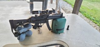

Accuracy testing started off rough at 25yds.
Not surprising given my goofy bag setup to clear the 30 round mags (I have a 20 in the mail.)
I didn't want to monopod off the magazine because at this point I was getting a serious malfunction every 15-20 rounds and was afraid of making it worse.

The results weren't what I was hoping for, but I wrote it off on poor ammo choice and pushed my target to 50 yards.
The LAX performance was, again, poor. I also didn't have enough 160gr to shoot complete groups.
The Blazer, however, pulled something incredible off. I have no idea how that cheap light ammo pulled this off from a 9" subgun.

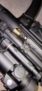

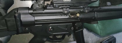

This was the end of the range trip, malfunctions had become a cardio workout they happened so frequently, and I was out of good ammunition. I was also havingto completely break position and remove the magazine to clear each malfunction. The 100yd groups were shot having to lift the gun off bagsfor remedialaction every other round! I can't believe I hit the berm let alone the target 🤣
Below are a couple pictures of malfunctions (one after removing the LPVO and trying in vain to zero my red dot)
After arriving home I set about to diagnose the issues. A friend suggested I check the extractor spring, thinking maybe one of the early FTF's had caused damage that got worse each time and snowballed. Looking at the BCG and inside the receiver I couldn't see any obvious damage. There is some slight "polishing" on the bolt from rubbing against something.
The extractor spring also appears to deviate from HK components, as evident by the color of material.
