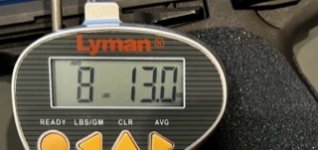

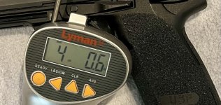

Bonus, here are my results for the the Match Kit on the USP 45:
Three-pull average - stock - DA/SA
Three-pull average - Match Kit - DA/SA
I was surprised the DA pull did not drop as much. I guess I was expecting 7-8 pound range. The SA is great. Overall the feel is much better in both modes.
