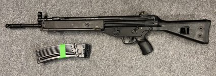

I just picked this beautiful II-Dated HK93 up yesterday from my FFL. This gun is in 99% condition, and I think it's only been shot a couple times.
This specific gun is destined for a HK33E SG1 (SBR) mod to receive a HK33 barrel (1/7 twist - 178 marked), paddle mag release, F/A carrier mod, SG1 stock, and remark to 33E.
Instead of SEF SG1 Set Trigger Pack, this will get a HK93 PSG1 Trigger Pack installed or the 4-pos burst pack from my MM23E. Optic will come later. I want a HK93/33 that has 1-in-7 twist and can handle up to 80 gr bullets; a 1-in-12 barrel is handicapped to 45-55 gr bullets only.
For Tony. This gun is a hodge podge of misc. dated parts akin to those found on IH/II dated desert & woodland camo HK93s. The forearm is ID, the buttstock is IC, the cocking handle is ID, the Bolt Carrier is IC, the Bolt is IF, the barrel is a short HK33 with none-removable extended flash hider which is marked IE XC (1-in-12 twist). This gun came with a Bayonet Lug, two 40 Rnd Mags and a Bipod.
