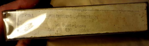

I still have a bunch of old CCI primers that I intend to use up:
Old ones still work. I would say if you are looking for precision loads get newer ones but I'm not sure if older ones aren't actually better. Just dug out the last of the old ones.
