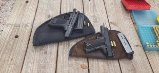

Hi,
Went shooting today and ran about 50 rds. through my HK.
I cast and reload, for the 9mm cartridge.
The bullet is from an MP Brass 4-cav. Mould 357-135 (heavy) bullet from wheel weights.
After 50 rounds checked the barrel and there was a little lead in the bore but was easily wiped out.
Was wondering if anyone else shoots cast and their experience with HK barrels???
