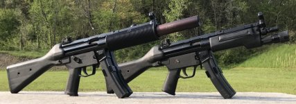

Took the MP5SD-Hybrid out and put it on paper. The couple flyers out of the Black were trying some bursts at 25 yards....its a shooter.

Took out the SD-Hybrid again tonight. I really enjoy shooting this one.

Nice results - is there any trick to lining up the SD front sights correctly when you weld them on?
Looking at the SD sights there seems to be a lot less to work with in terms of getting them positioned exactly.
Grease Gunner
548
Tuscarawas County Ohio
The biggest issue is getting the cage straight with the barrel. Once you get that done, the front sight isn't bad.....its the prep work to get it to that point is the hard part. Lot of back and forth welding to make sure things don't pull.
Exactly…
